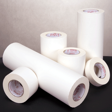

@Jimmy , whatās the stuff we use in house?
Blue painters tape works well. In house weāve used paper application tape used in the signmaking industry. Usually medium to low tack.
