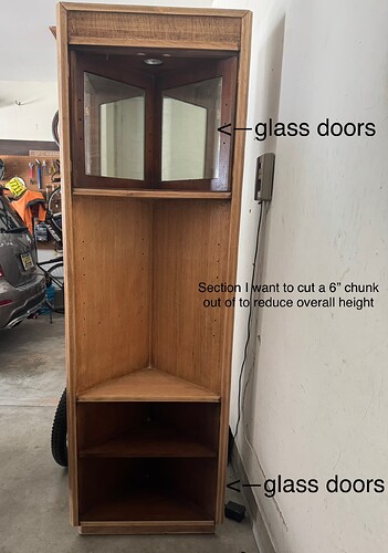

Hi, I’m new to the maker’s network and have absolutely no experience. I’m hoping to get some crowdsourced insights about the best way to handle a project. I have an oak corner shelving unit that is about 6" too tall for the space I’d like to put it. Based on how the unit is built (glass doors, etc.) it’s not going to work to simply cut 6" off the top or the bottom. So, I’m thinking I need to cut a 6" chunk out of the middle and reattach the two halves. My questions are:
  1. Is that a terrible idea? Is there a better way to approach this?
  2. Does the maker’s network have tools that could help me make 2 perfectly straight cuts through a corner shelving unit? If so, what tools and how do I reserve them?

Yes! Here’s a photo (the upper and lower cabinet doors have been removed and I am partway through stripping and sanding to refinish):
Hi,
I think the easiest and safest tool for you to use is a track saw. The makerspace has one, and I can show you how to set it up and use it.
Wow… I don’t think I’ve encountered this before. Questions…
Can I assume this isn’t a family heirloom?
I like Charlie’s idea - a track saw seems like a good way to do this. But it will leave a seam. Have you considered how you will deal with or hide that?
This will also weaken the piece. Any thoughts about how to reinforce it, or join the 2 ends at the cut?
Have you thought about making another one, similar but shorter? It’s more work, I know, but…

  • Not an heirloom
  • I think the seam is inevitable and I’m OK with that.
  • I have 0 ideas about reinforcing. Maybe braces on the back?
  • Make another one is unfortunately well outside my capability!

Also, in my work, I’ve had to cut off tall cabinets and doors that don’t fit using this technique, and it has worked fine.

My suggestion to hide the seam would be to make the cut as close to the bottom shelf as possible. If that doesn’t affect the strength if the overall structure.
