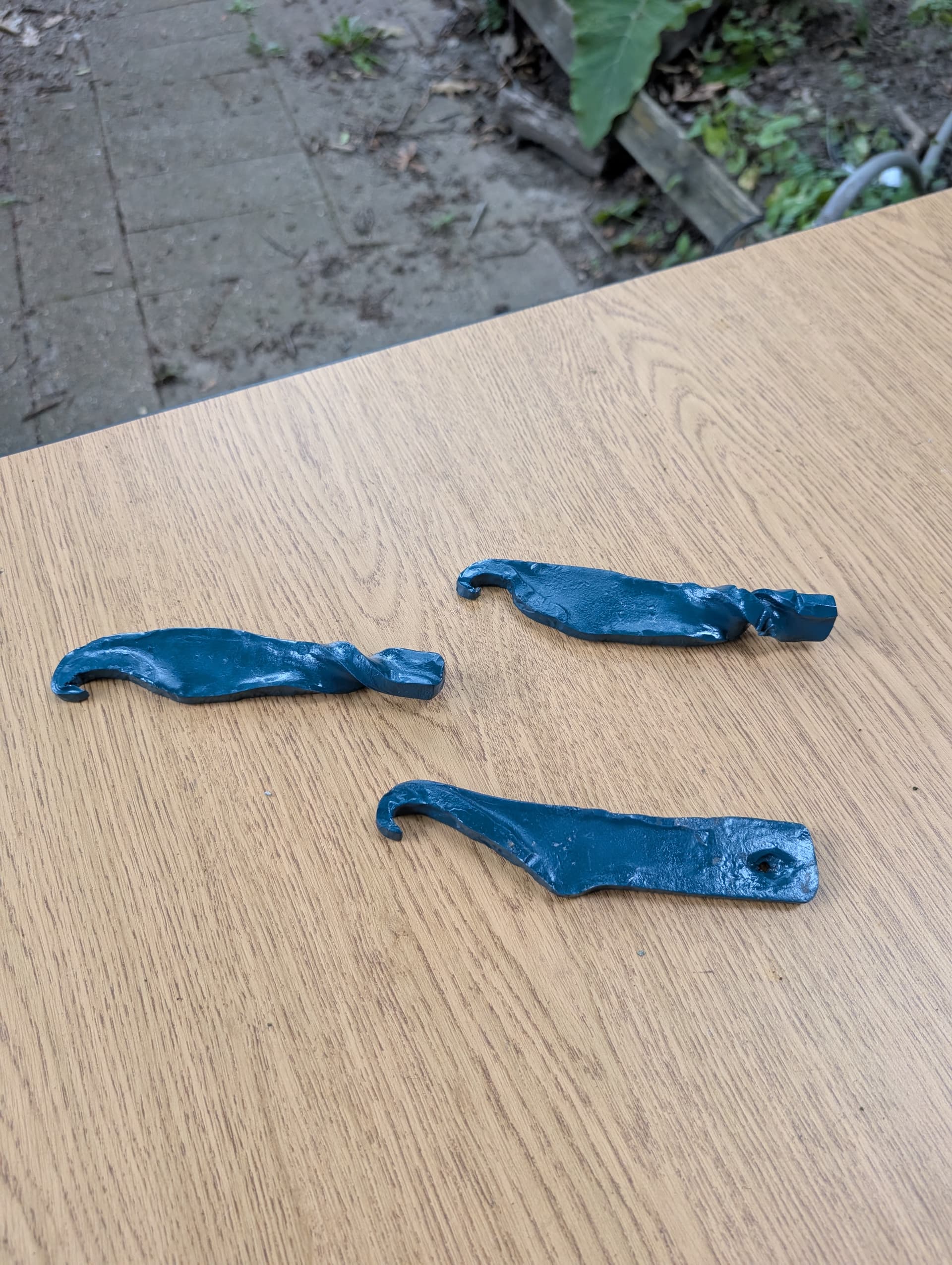

Made some bottle openers today, and they actually worked!

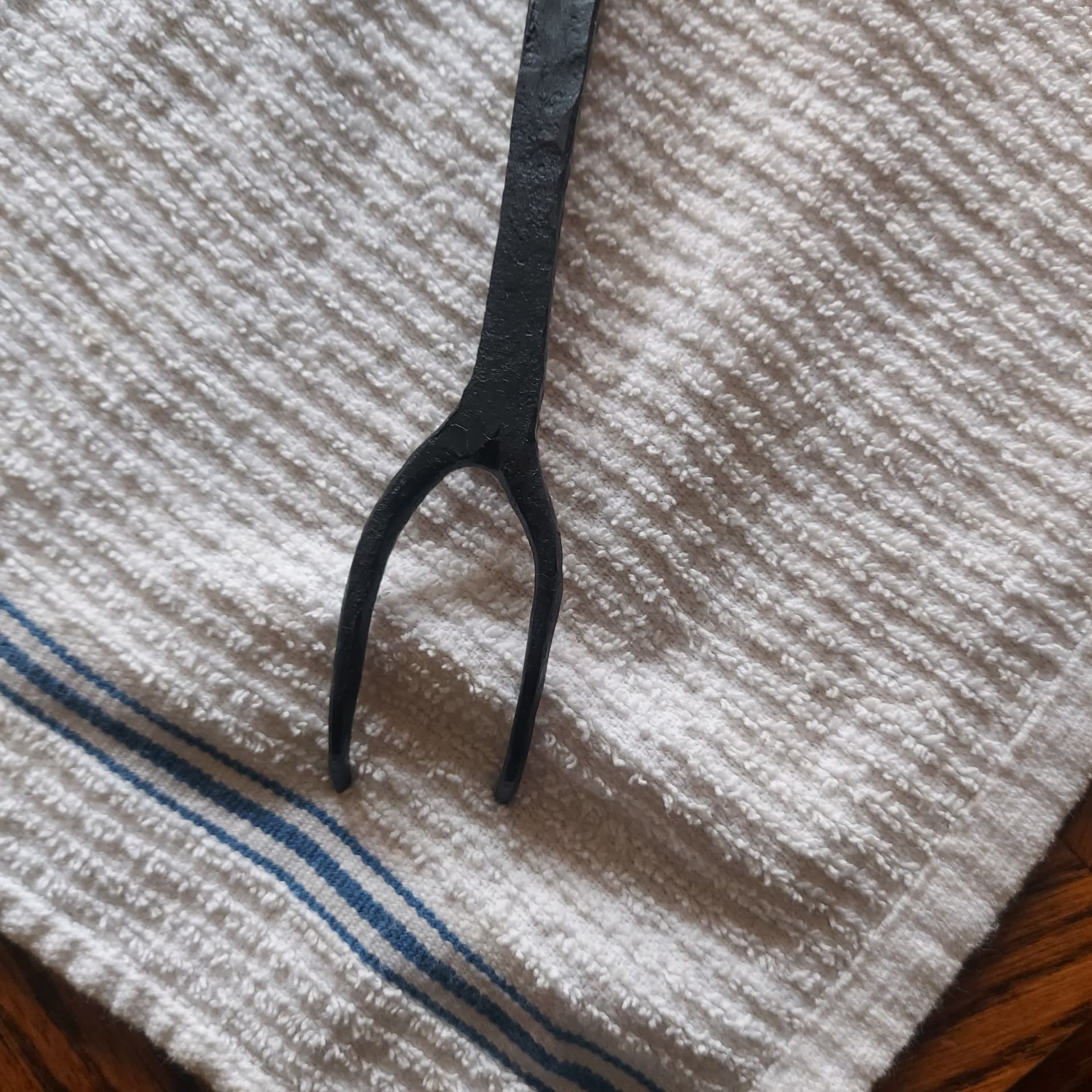

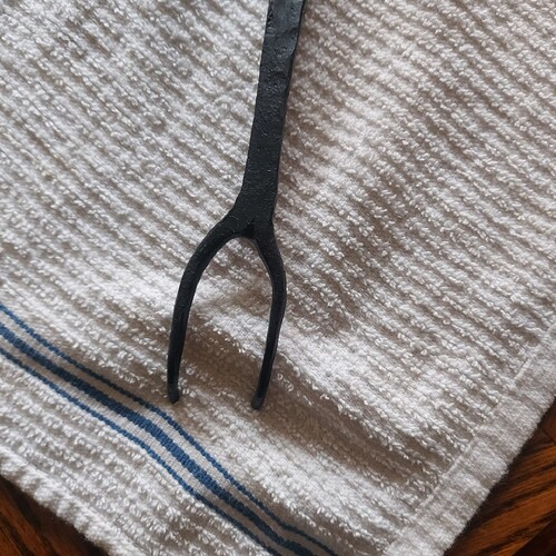

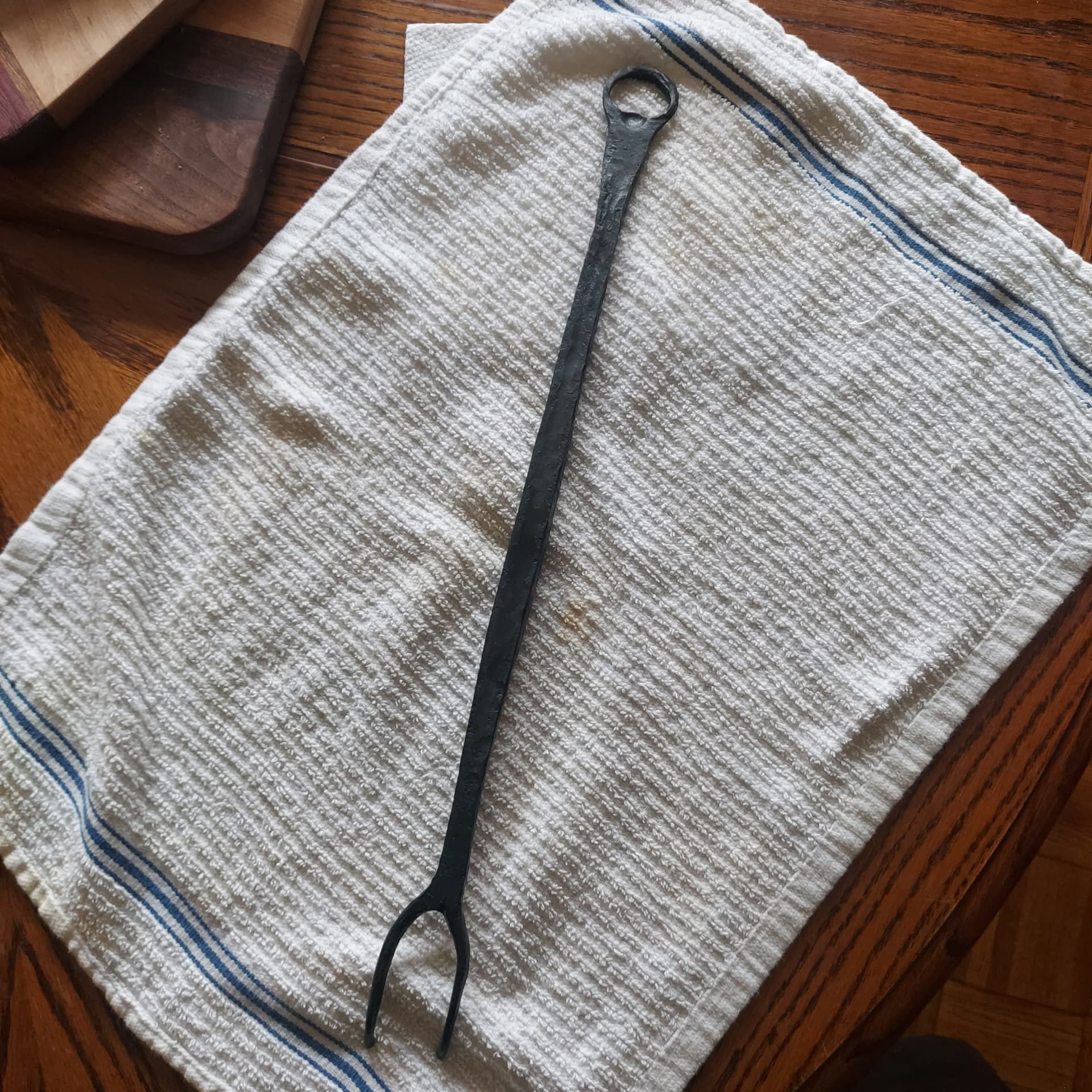

Now make something cooler a meat turner and a bottle opener . Good work now to challenge yourself with another cool tool.

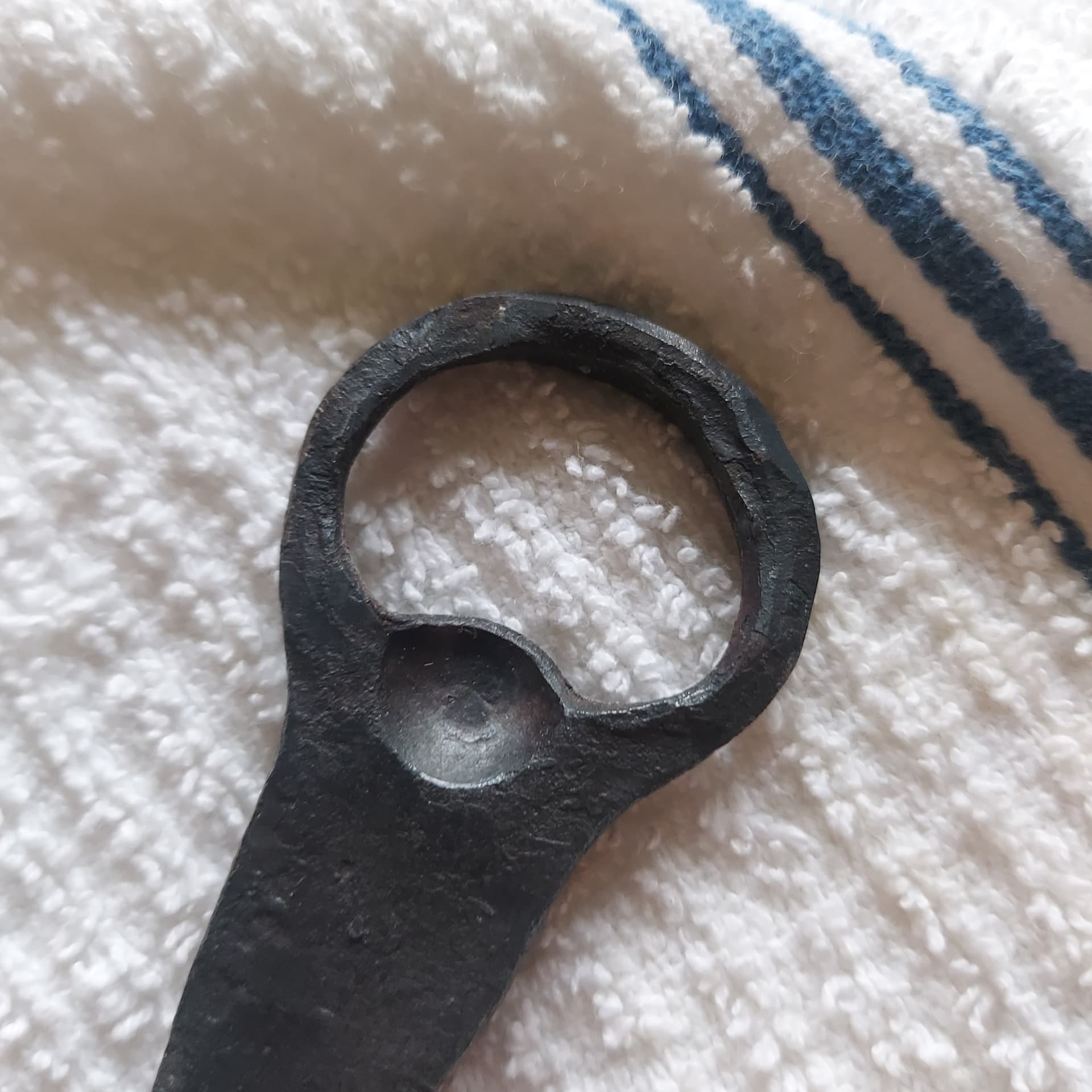

That is so cool! That will be a fun challenge there. How did you punch the lip for your bottle opener, and shape such a good circle?
Whoa these bottle openers are fantastic!
Drift the hole to about 1" , make oblong then use a ball punch to make the dimple that goes the under bottle cap.
