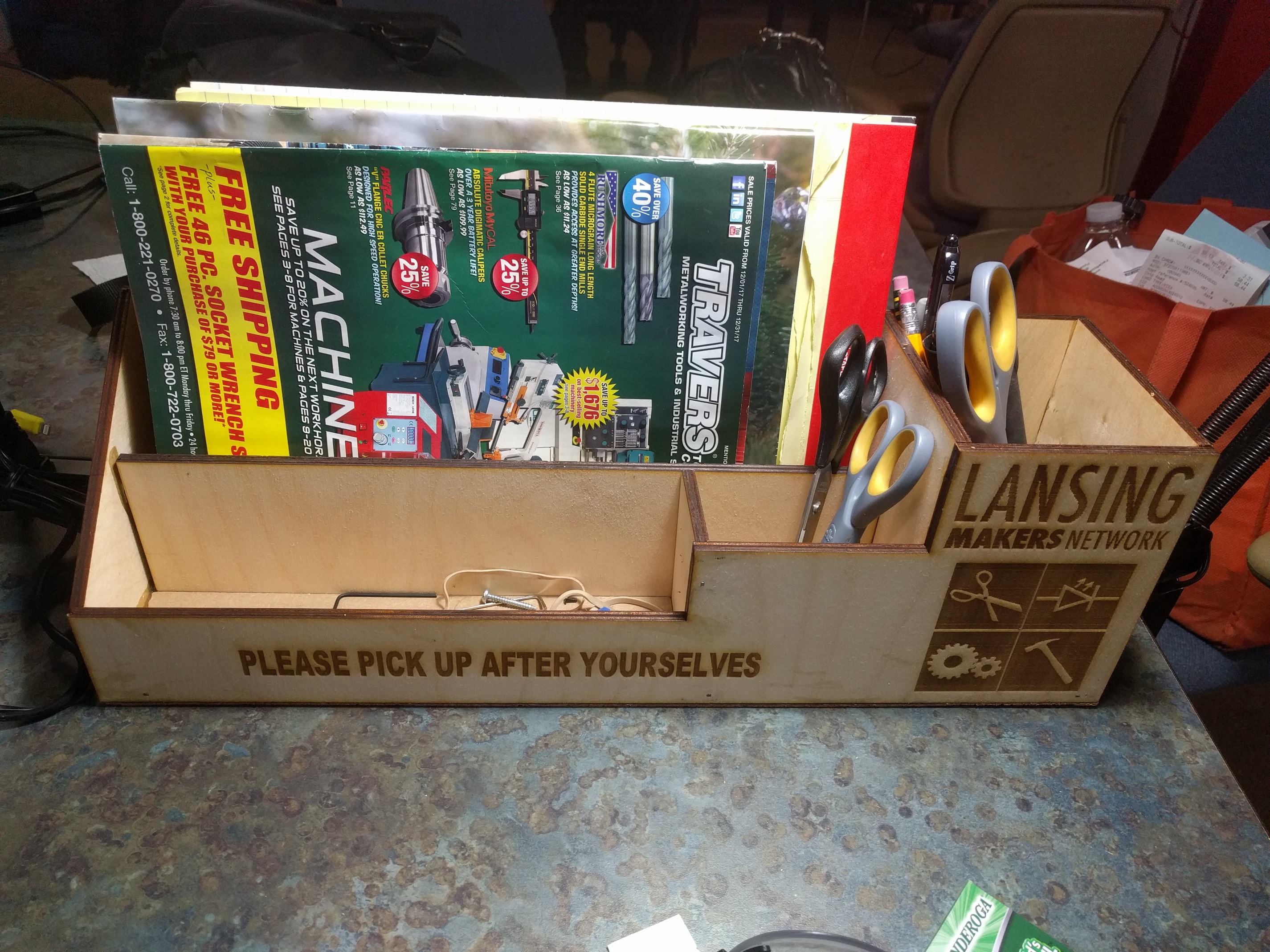

The original VCarve file for the base got corrupted, fortunately AFTER I output the G-Code. However, the RDWorks file is on the computer next to the laser cutter. In “Documents” is a folder of my name, within that is the “Desk Organizer” file. Anyone looking to use that file is free to make a copy and do what they with with it. If the G-Code is desired, I can add that to the folder as well.
Everything but the hidden base was laser cut. The outside 4 pieces make a skirt around a 1/2 thick base which was routered on the CNC with 1/4 inch channels. The parts that go through the center are glued into those channels. If you look inside the unit, you can see the different material. I did that for both added structural support and extra weight to help prevent it being tipped over.
