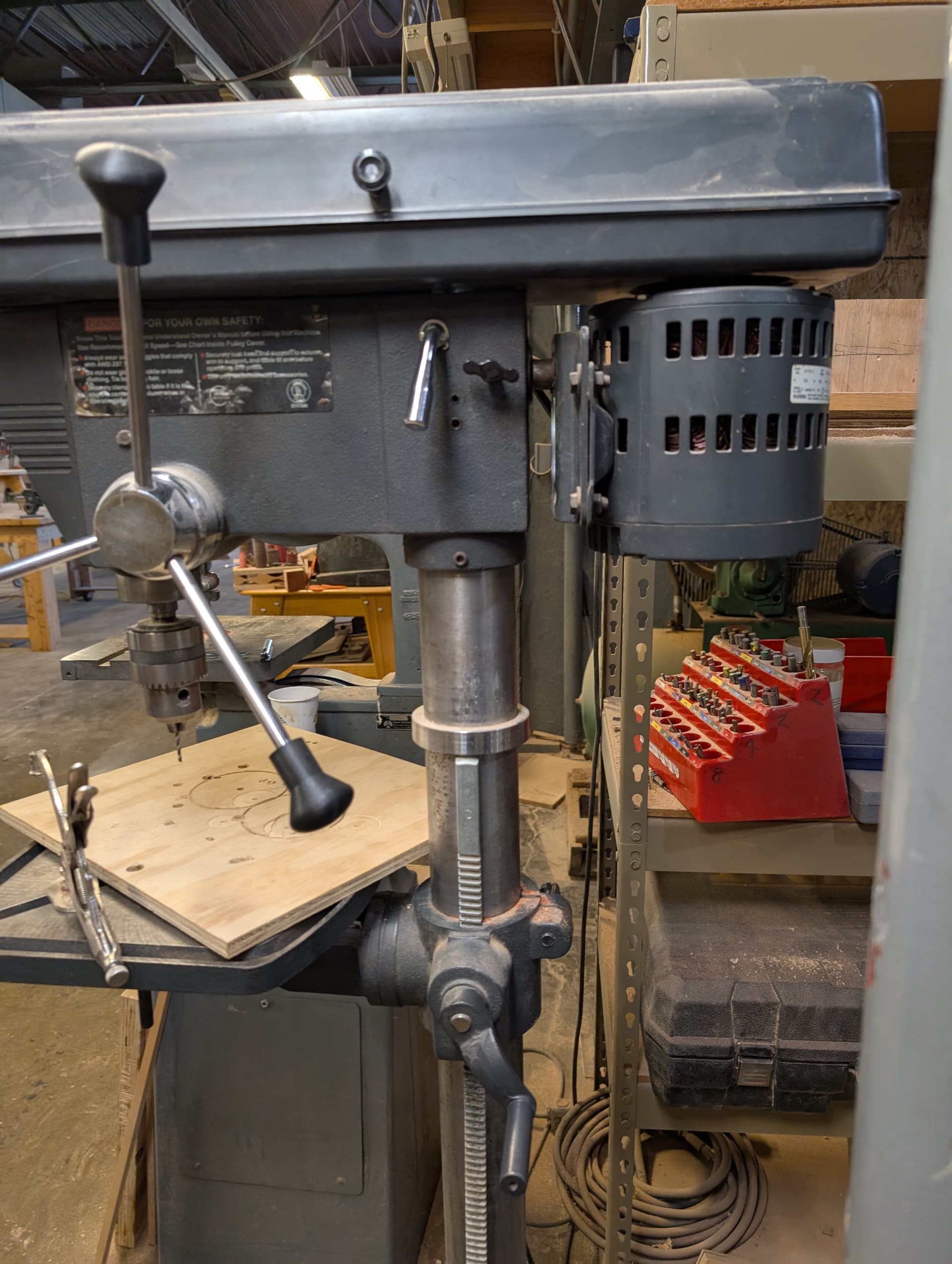

** Trying to lower or raise the table on the drill press is difficult as the rail has buckled. (Please be as specific as possible):**
Did you unlock the red clamp lever on the left side of the post- opposite the crank? This MUST BE UNLOCKED before moving the table.
I will be in tomorrow to look at this.

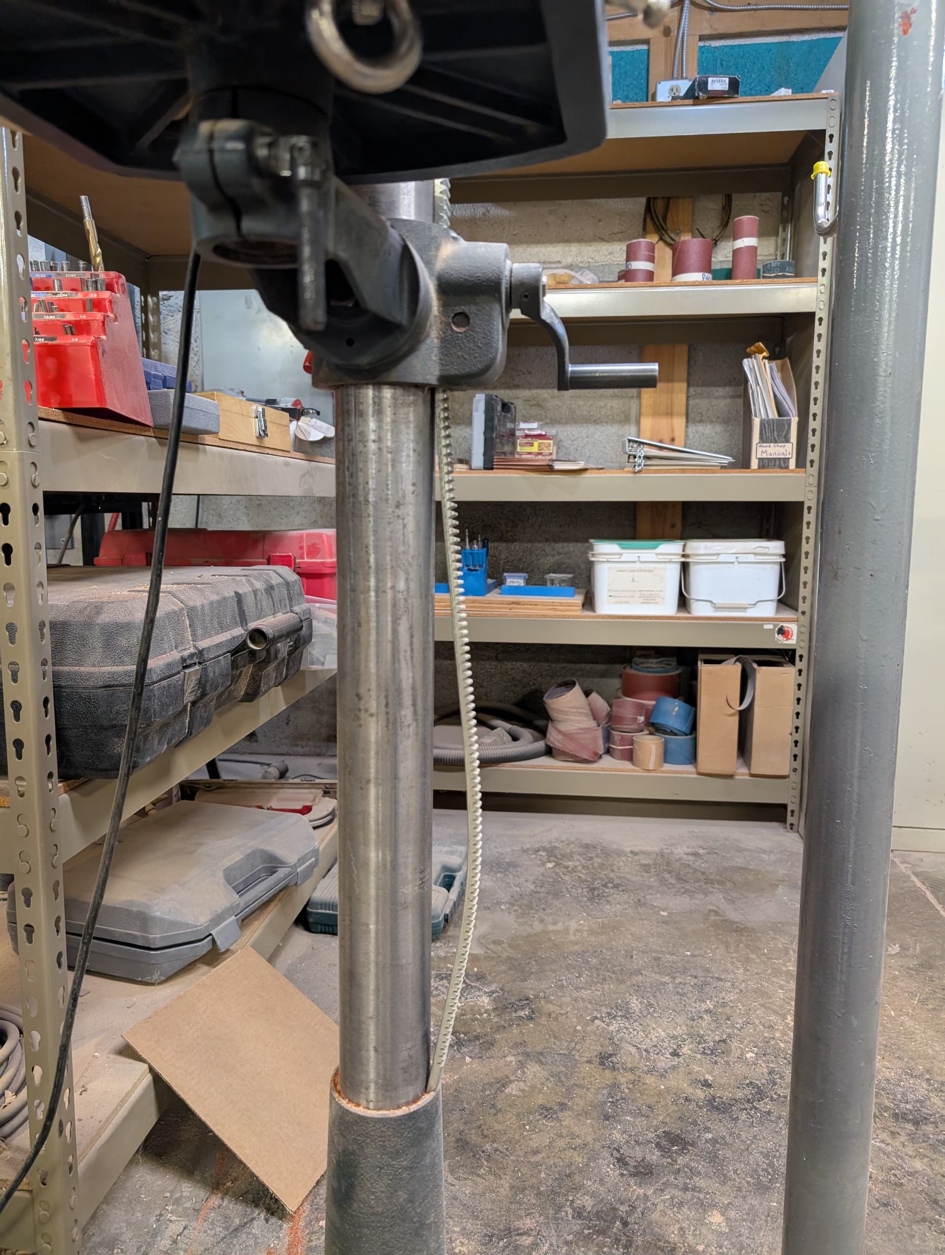

The rack on the side is bent, and i don’t know if it can be straightened. As a temporary fix, i put a couple of wire ties on the rack. The drill press is usable, but please use the tool with care.
This has been repaired. Please remember to unlock the adjustment lock (the red lever on the left, behind the table) before tryng to raise or lower it.
