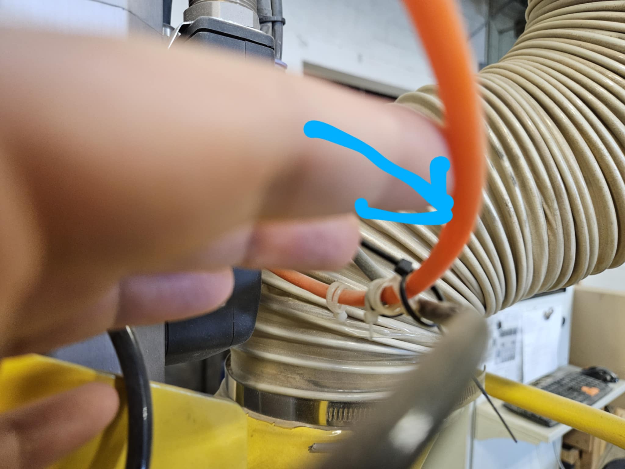

There’s a leak in the orange airline coming off the router head
I was trying to change tools, using M06 Txx, and the generated program would stall out after the skirt lift. I’m guessing that there’s enough pressure to make it move, but not enough to trigger a sensor
I did reboot the machine three times to see if that’d be helpful
I’ve let @RealCarlRaymond know as well, and we’ll figure out how to replace that line, and go from there.
Do not use the machine in the meantime
