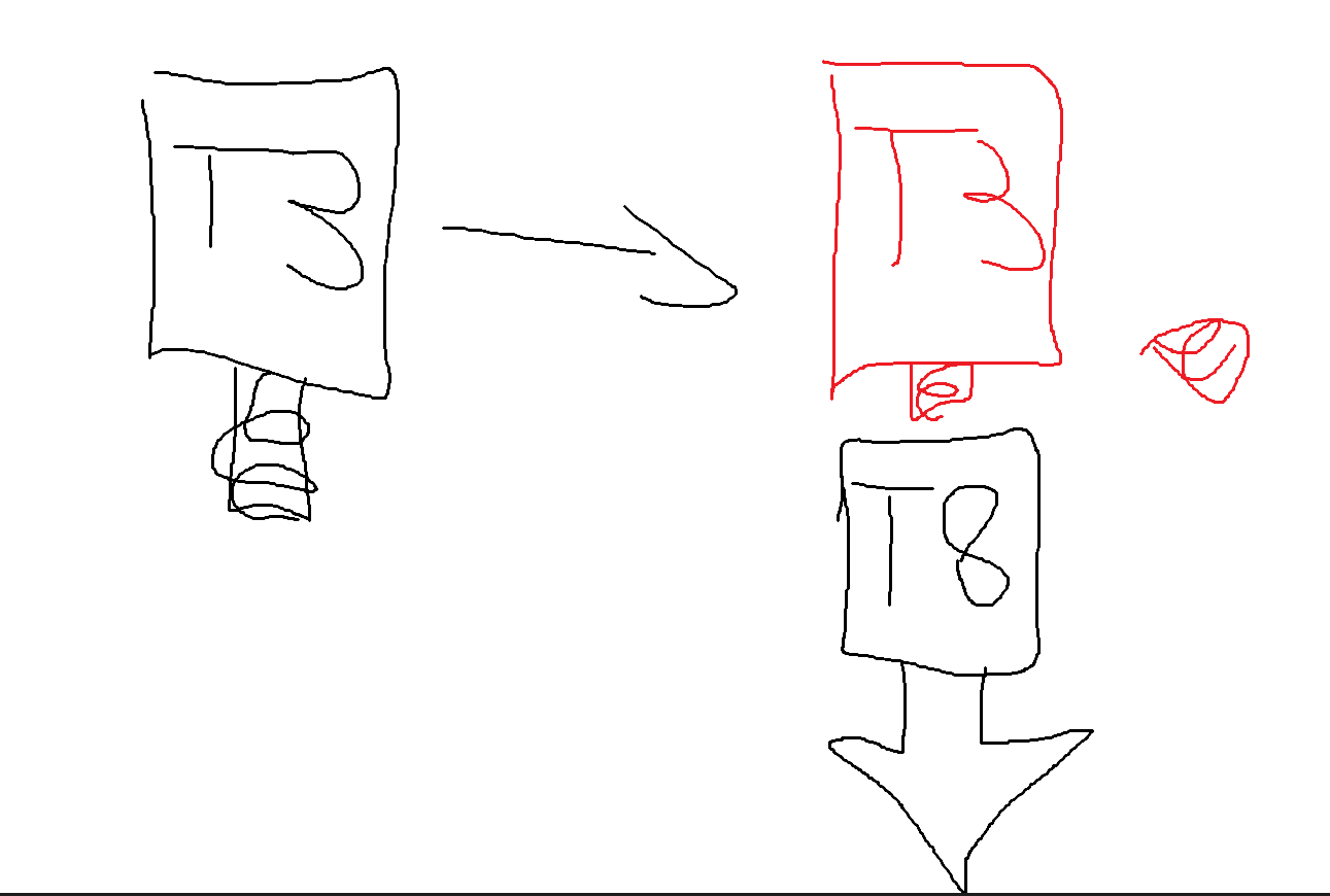

I was using the CNC yesterday, and I crashed the machine (it is running fine dont worry). Heres what happened.
Crash -
The tool change command was running (from 3 to 8), and bit 3 was being placed in its holder. Just as it was being placed in its holder, the machine ran out of air (The breaker for the air compressor had tripped, so it was slowly loosing air pressure), so it stopped the program. I then reset the breaker on the air compressor, then reran the tool change command (from bit 3 to bit 8). For some reason, it had thought there was no tool in the spindle, so it ran right over to tool bit 8 to pick it up. Of course, there WAS tool 3 in the spindle, so as it ran over to pick up tool 8, it crashed. I panicked and hit the EStop. Both tool 3 and 8 had fallen on the table, and tool 3 (3/8in 2 flute downcut bit) has broken.
(Im not an artist, dont judge me :slight_smile: )
