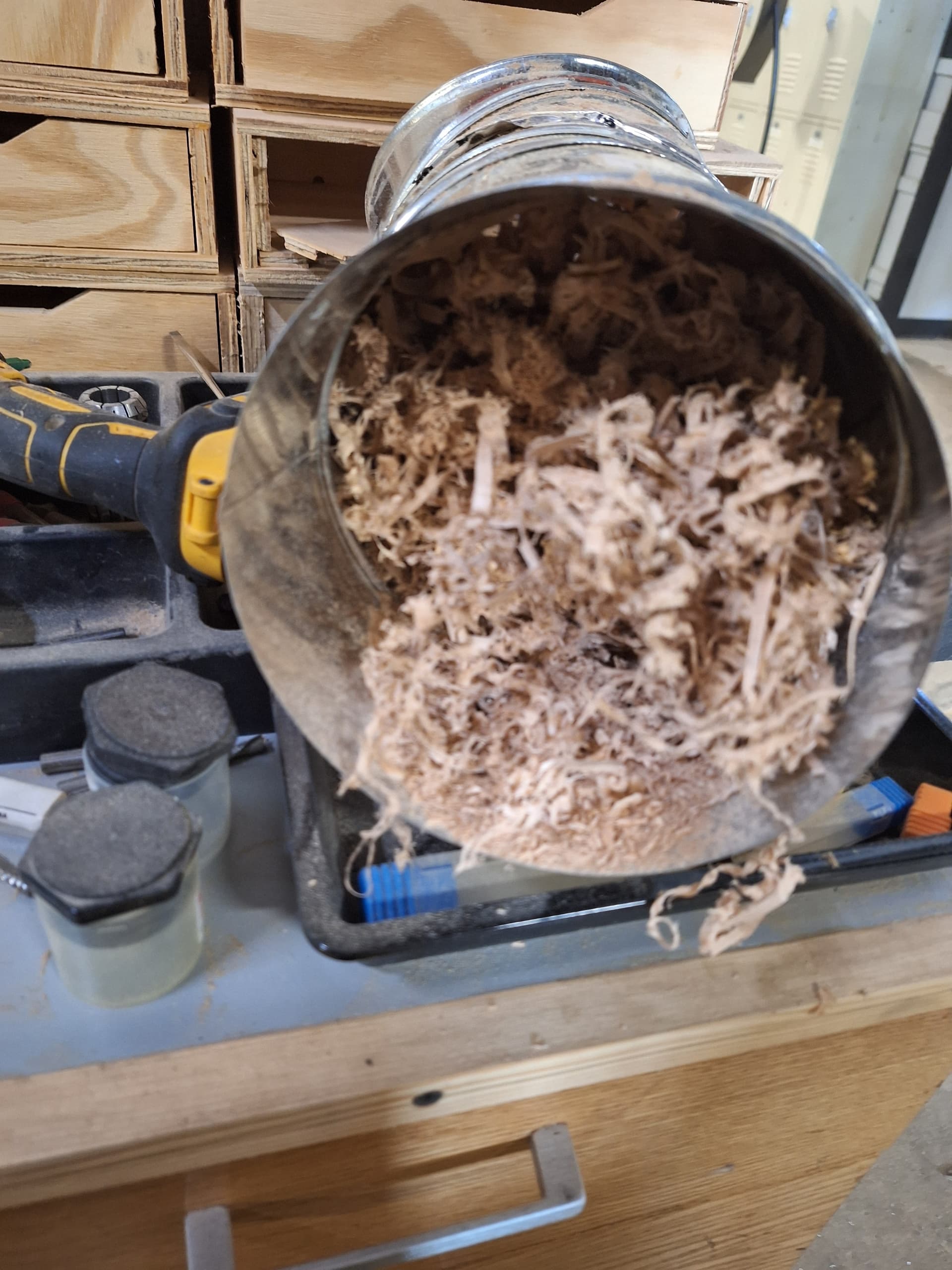

I was using the cnc today. Manually using the spoil board bit. But when i tried command m401 to probe a too the machine switched to mm ftom inch and started getting probed error. Indicating it traveled beyond the z axix. Evelyn knows, i also oppenef a request with NewCnc just in case they can help. If you know anyone who has input or experience pleade post here. If you have a checkout scheduled sunday, watch this space for updates. Og i also unclogged the dust collector on the cnc. If you notice its not doing anything say something in the future
