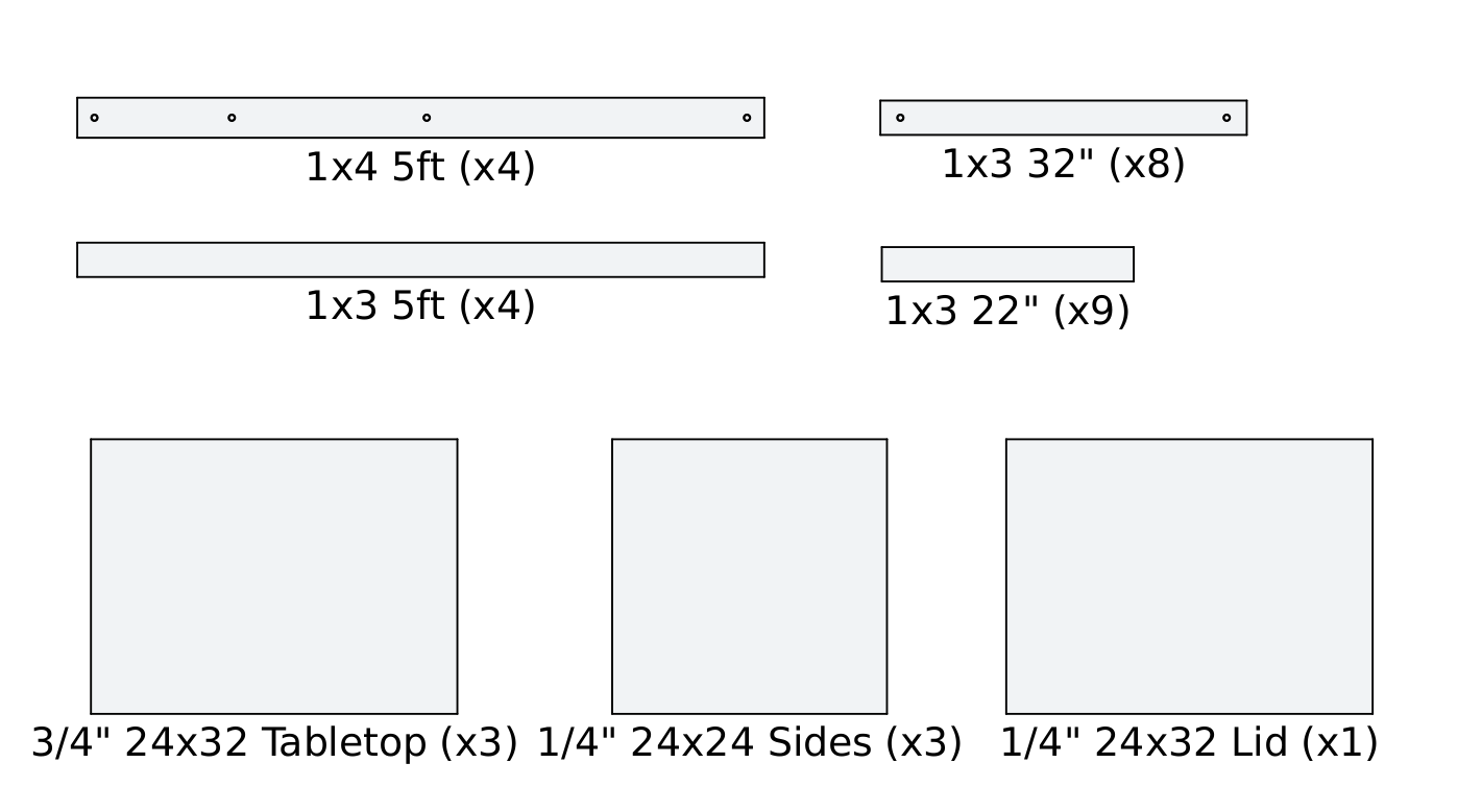

I’m interested in cutting some 2x4s and some plywood to build a basic stand/enclosure for my 3D printer at home. I think I’ve gotten the design down to something that just needs a few basic cuts:
Image of 3D printer table design. There are 4 60-inch 2x4 pieces, 6 30 inch 2x4 pieces, 3 28 inch 2x4 pieces, and 3 32x32 inch plywood pieces with 2x4 cutouts in the corners.
I’m probably going to need the miter saw to cut the 2x4s; I’m not sure what tool would be best to cut out the corners in the plywood.

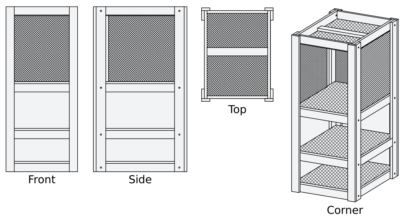

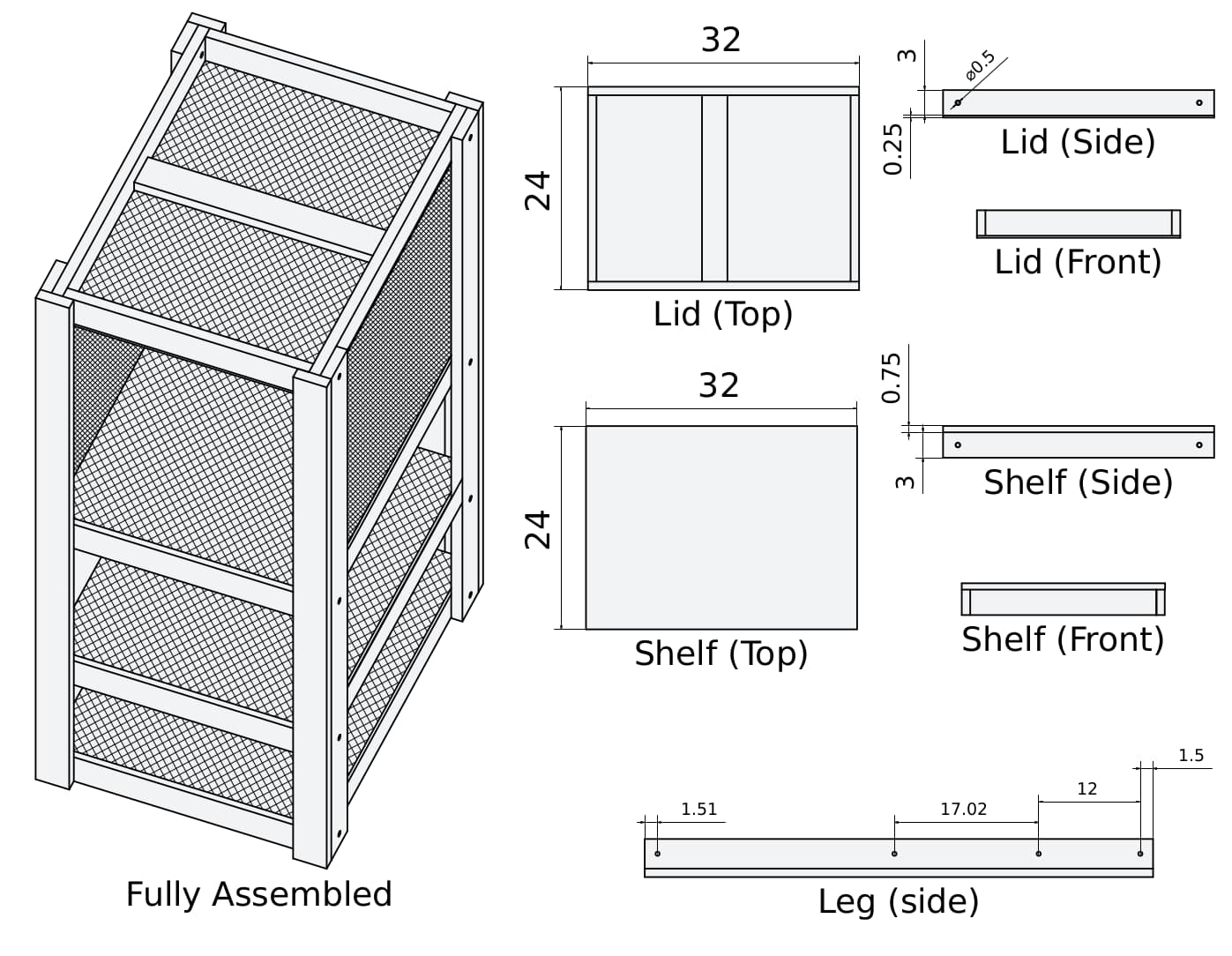

Dan, let’s talk about your design tomorrow. Maria is right, there is usually no need to notch the corners, unless you have some specific reason for that. I’ll show you more about what I mean when we talk. It would help if you can bring your diagrams, either a digital or the dead tree (paper) version.
Based on Tony’s feedback, I’ve made some significant revisions. I’m going to effectively make the bottom shelf the main support for the entire shelf, with each of the four legs bolted to the shelf (and to all the other shelves; bolts since I want to be able to disassemble this for transport).
I’d be open to any last-minute feedback (especially from @Tony); I’m planning on getting the materials and getting started tomorrow.
