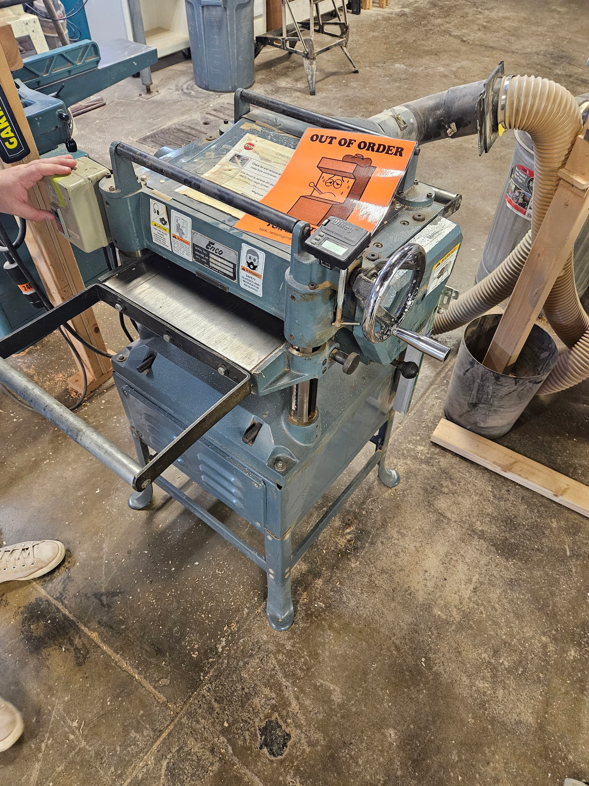

Affected Tool or Resource: planer
Team, Group or Volunteer who usually handles this type of ISSUE or REQUEST (Please tag using the @ symbol. Start by typing @TEAM_ to find most responsible teams): @TEAM_Woodshop
Planer was working today. @MatthewBrau was using it, and turned it off while it was working fine. Tried turning it back on, and it’s not turning on. Shop was noisy, but it seemed that the planer was putting out no sound when on button was pressed
Out of order sign is currently resting on the machine

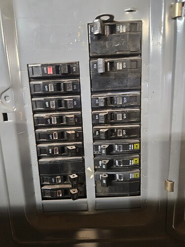

Tony called in and recommend I check the breaker panel. Breaker 1 is tripped, and I can’t reset it. But it also looks like that’s not the relevant breaker anyway

Yes. The circuit breaker had been tripped.
