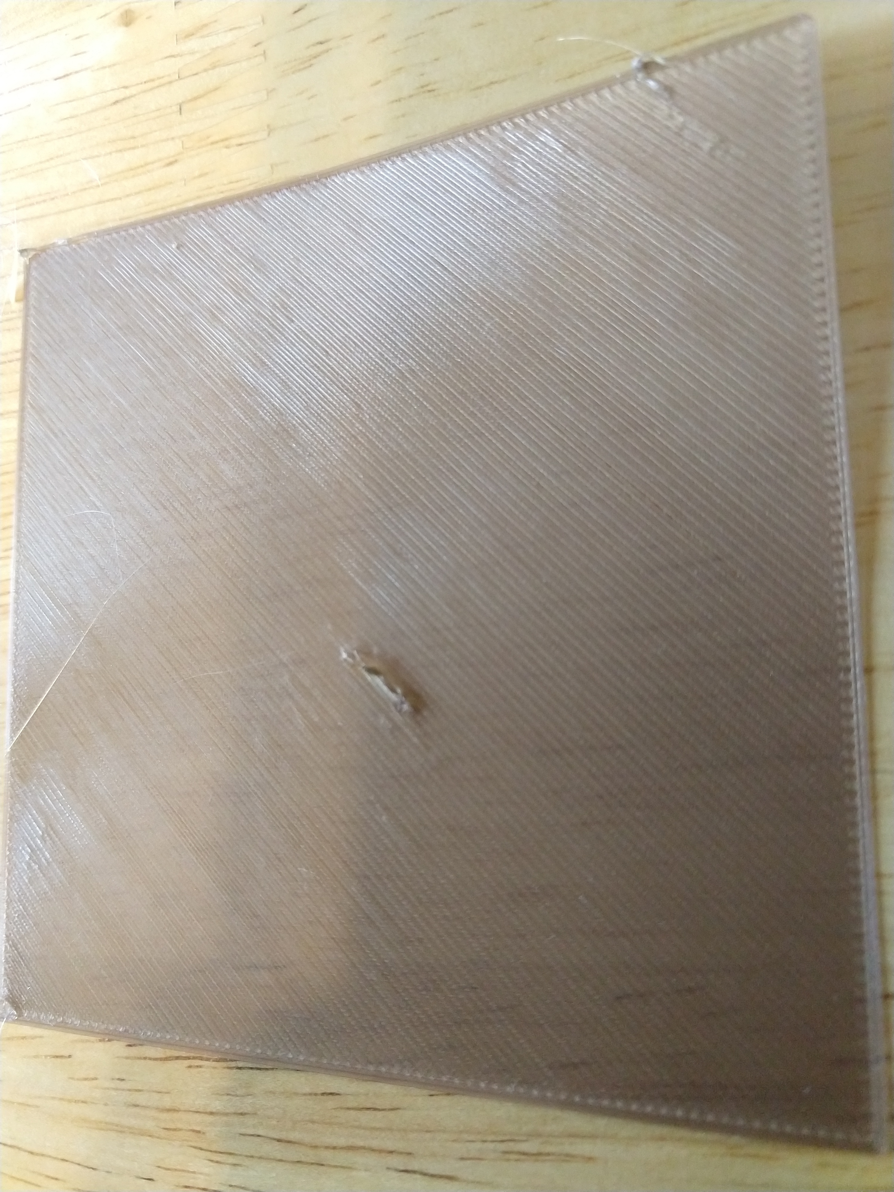

I’ve been tuning 1st layer height all day. I think it’s good now. The photo is 80mm square, and looks good except for a few boo boos. Maybe just filament problems there.
