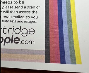

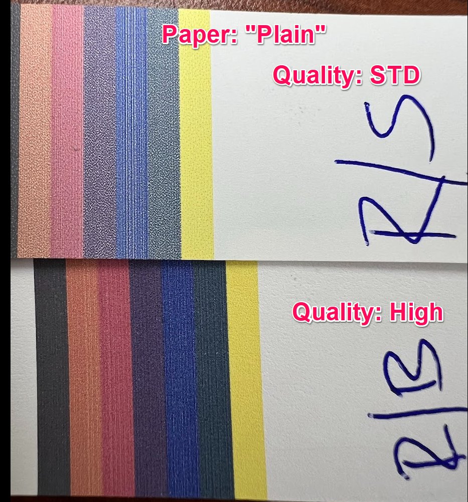

With the printer set to paper type “Plain Paper” we definitely get some lines in the print. Not as bad as what your example shows with actual holidays in the printed output though. The spacing between the lines looks to be too large to be the printhead though (I’m not however going to stake my life on that, it’s absolutely possible that just printing more opened up the clogged nozzle).

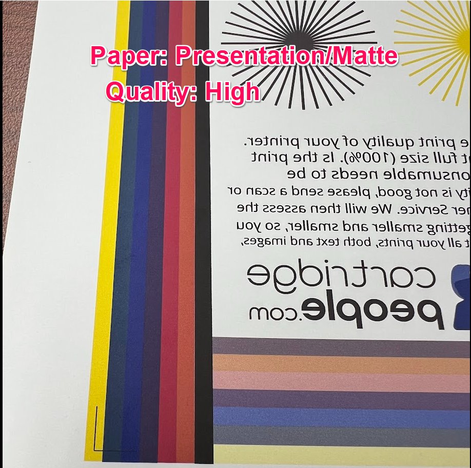

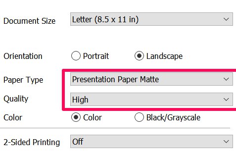

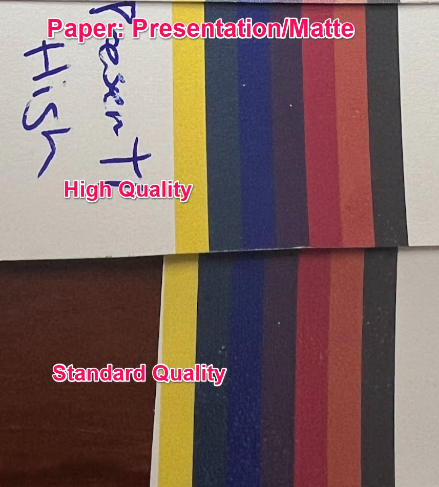

However, I’ve always used paper type “Presentation Paper Matte” in the driver and print quality “High” which results in a lot more ink on the page. Note that a print will take considerably longer than with the paper set to “Plain Paper”.
So for comparison (note the print was rotated for these samples so the stripes are “vertical” in these:

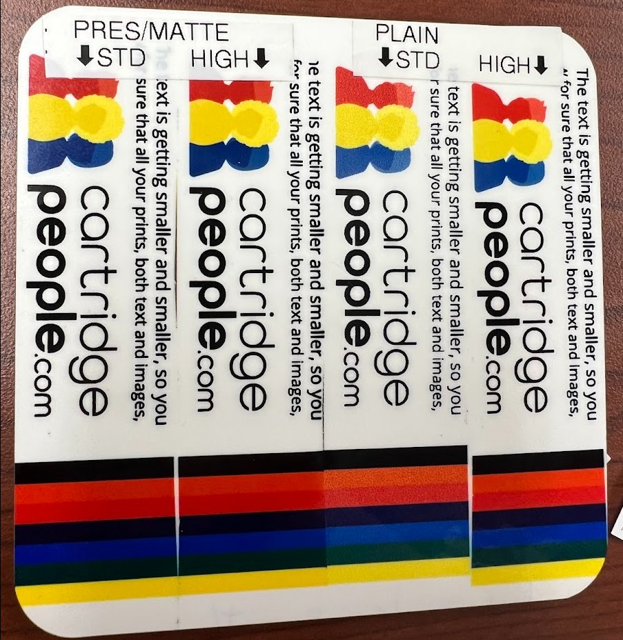

Last, I did a sublimation test on a spare blank. The transfer itself helps smooth things out so light variations aren’t particularly noticeable (although certainly are when compared side-to-side.)
So, that’s not to say “it’ll probably be fine”, bc I think those lines definitely would have been in your finished piece. If changing the paper setting doesn’t do the trick, we might need to see if it happens when I print that same file to figure out where in the chain the problem is.
